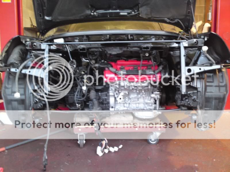

So here's my own engine, being transplanted into the Mk3. Pictures tell a thousand words so here's a few thousand words.
The full setup is :
1MZFE 3.0 V6 all alloy
F1 Chromoly Lightened Flywheel
Hybrid Clutch with 6 paddle plate
S54 gearbox with Celica Final Drive and Mk3 LSD
Apexi Induction
Genuine F355 Exhaust system
And it sounds, like this :

The results with this swap mean that again, the car feels like normal through the corners but as soon as you've clipped that apex you're off like a scalded dug. :D
The engines themselves are pulled from Toyota Camry's which can be picked up fairly cheaply, stripped, cleaned, painted and rebuilt with new headgaskets and seals. They go on for 200K miles in most cases. Some more. Very over engineered which means very reliable for us.
I'll be having the car weighed in the next few weeks to see exactly what the figures come out at. i'm hoping for it to be still sub 1 tonne. :thumbsup
