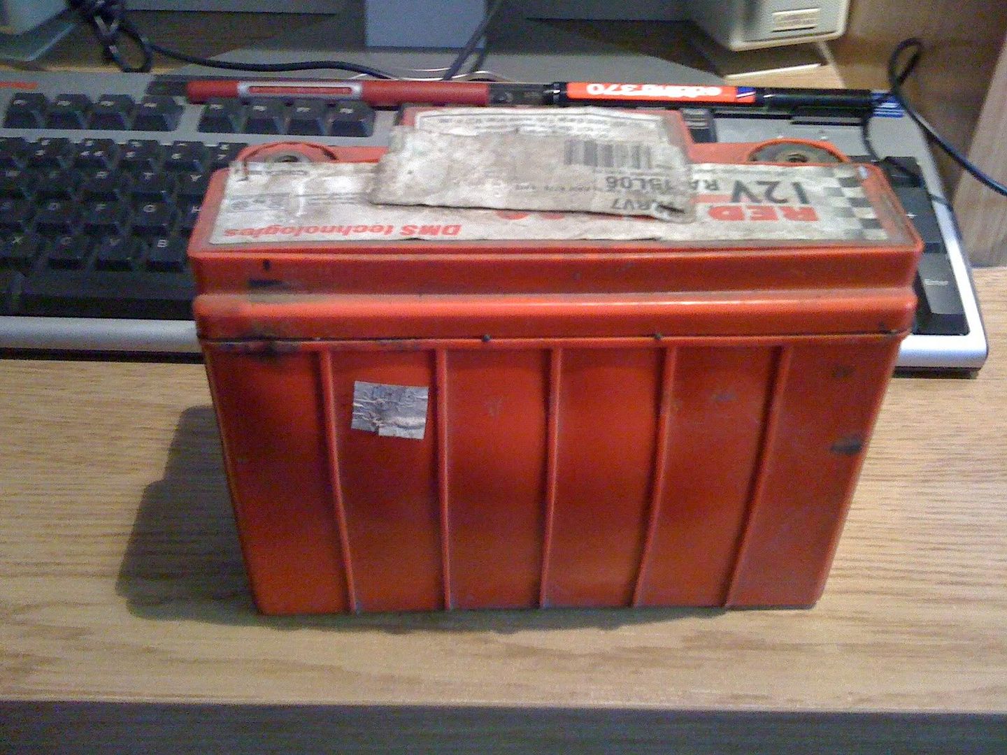

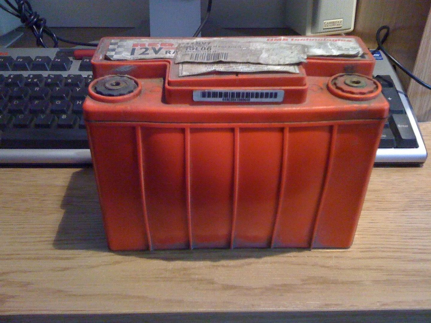

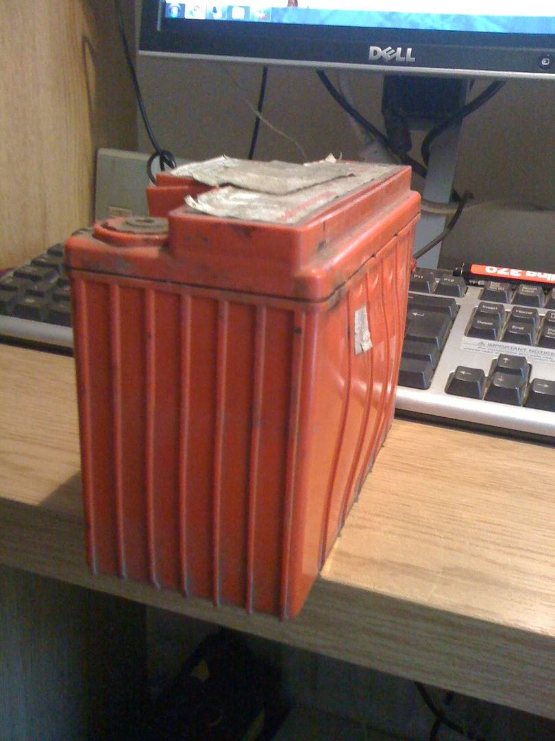

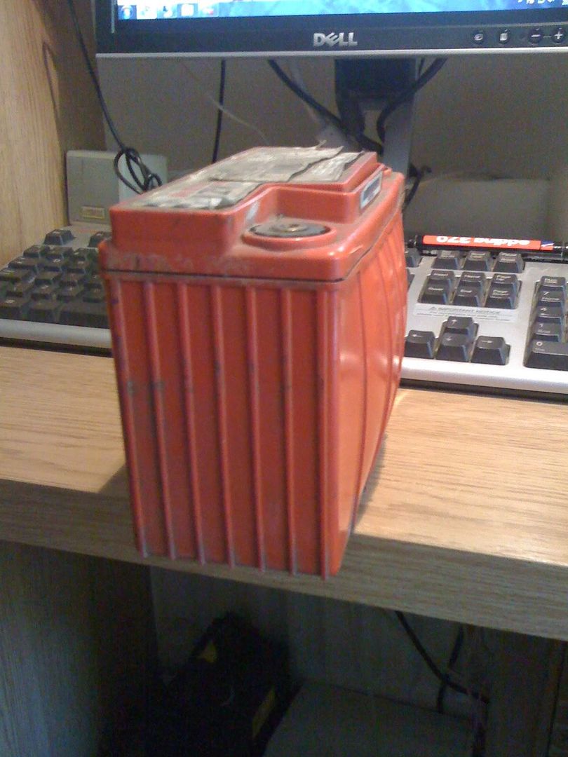

Post by Sanjøy » Sun Apr 25, 2010 4:15 pm
Finally popped in the Odyssey 545, old one looks well out of shape, could it be a product of continued trickle charging ?

Nice bulges Sanjoy, looks as if it is about to give birth.

Unlikely to be trickle charging unless the trickle is a bit large for the battery. Contact Odessey see what they have to say - can't be far off splitting the case and spewing it's nasty contents

Rich H wrote:Unlikely to be trickle charging unless the trickle is a bit large for the battery. Contact Odessey see what they have to say - can't be far off splitting the case and spewing it's nasty contents
Low amp bike trickle.
The thought of Mckean causing a buldge.....

"When a battery swells like yours it is normally a sign of over-charging. The battery will heat up and soften the casing before the internal pressure distorts it. All the acid within Varley Red Top batteries is contained within an absorbent glass mat so this will not come out even if the battery case is ruptured.
If there isn't a fault with your charger/alternator, it usually means the battery has become over-discharged at some point. A short-circuit within 1 of the 6 battery cells can then form, thus reducing the nominal 12V battery to only 10V. When this battery is recharged with a 12V supply, the battery can swell as your has. "
