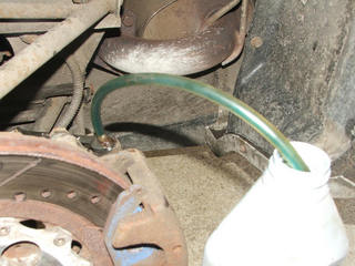

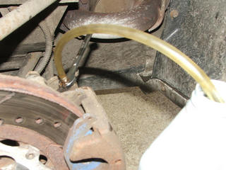

Be interested to hear if HiSpec actually reply on the brake fluid front. ATE TYP 200 and ATE Racing Blue (both on HiSpec's site) are exactly the same specification fluid except for the colour. The Racing Blue being blue coloured and the TYP 200 being normal brake fluid coloured.
The idea is that you switch fluids each change and you know when you've got all the fluid through when the stuff coming out changes colour:
Trouble is I can't find anywhere that will sell the TYP 200.
Eurocarparts will sell you ATE blue for much less though £10.45/litre+VAT (Part no: 130339010) but they can't get the TYP 200. If HiSpec do reply - I'd like some TYP 200 if you're organising a group buy.
