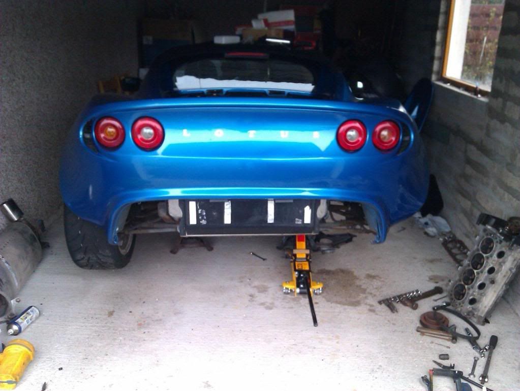

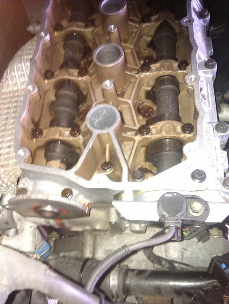

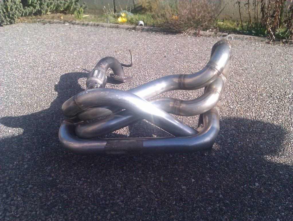

Post by steviej » Sun Mar 13, 2011 1:30 pm
Here are some photos of the work in progress
