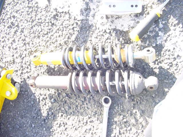

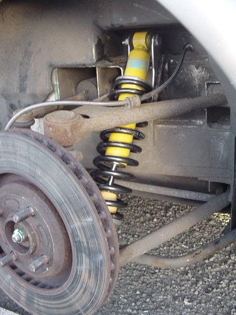

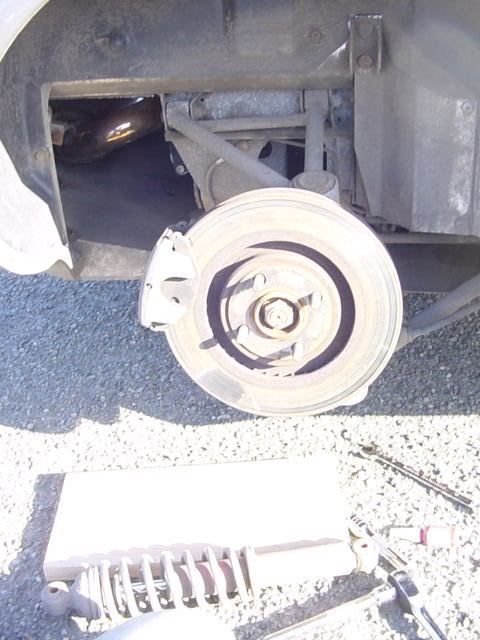

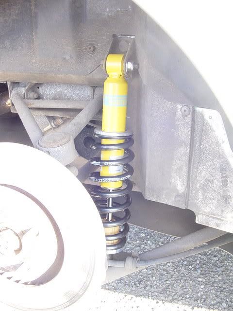

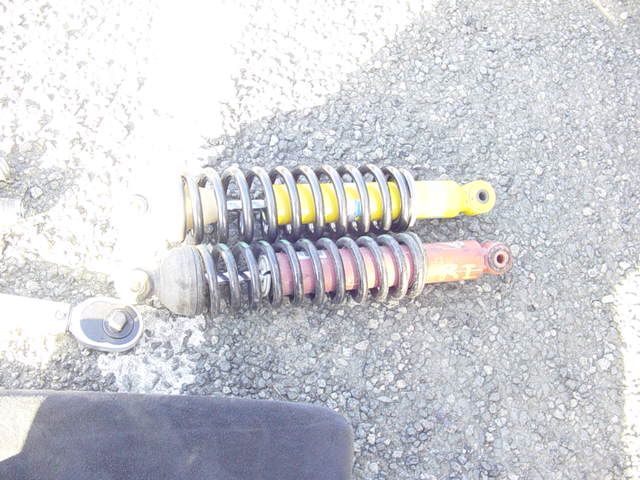

Some pics fomr my install:

I didn't need brackets of the ride height I wanted, 120mm, the brackets are bolt off bolt on unless you have an old S! then the front brackets will require a hole drilling in the front structure. Just bolt up the one that fits and use the bracket as a drill guide. New bolts and nuts use drualac and don't use stainless!

Sorry meant I didn't need brackets at the rear the fronts needed them see here:
