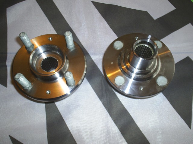

S1 hub flange
S1 hub flange
Pretty sure this MGF one is the same, certainly looks it, but could anyone confirm?

Re: S1 hub flange
It does look the same. I do wonder about the condition of the item in the photo though - looks like the flange has been turning in the bearing or it got a right mullering whilst being removed. Better than nothing if you're stuck I guess.

Only used that one as a comparison, looks a bit worn, but it opens it up a lot more if it is the same as there are plenty of complete MGF hubs going for the £20 mark with the flange attached, just ditch the hub.
Need a flange to finnish off a spare set of rear hubs with new bearings fitted, and half way to building up a front set.

Re: S1 hub flange
I don't think they are the same,
nearly, but on the MG hub flange there is a ridge where the LOTUS brake disks don't go over (centre hole in the disk gets stuck on that ridge)
Re: S1 hub flange
Thanks Bob, just what I needed to know.

Re: S1 hub flange
This is a new MGF one Bob, just compared it to the EliseParts one and it looks identical on both front and rear faces.
Re: S1 hub flange
good, I must have had an earlier version ????
try the brake disk just to make sure, it should go all the way till the flange. I had to scave off a bit of the edge of the centre hole on the disk.
