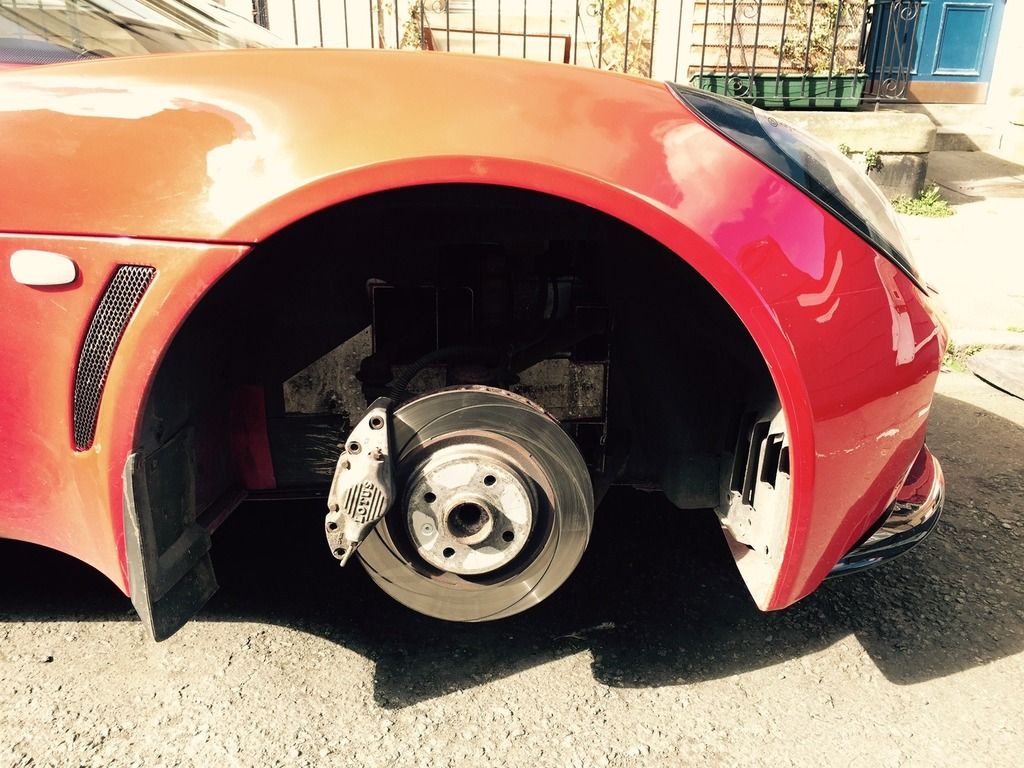

Post by a4drk » Sun Apr 26, 2015 5:04 pm
I think they are ........

Re: S2 Exige - Are my front brake discs on the wrong way ?
Post by robin » Mon Apr 27, 2015 8:04 am
The curves should trail the direction of rotation, i.e. the other way around to those in David's picture.

A quick google image search as I was convinced I'd seen straight vanes, and I found a link with straight vanes and an arrow pointing to the front ;)
http://brakedepot.co.uk/Fitting-Guide.html
a4drk
Posts: 2222
Post by a4drk » Mon Apr 27, 2015 9:02 am
Thanks guys
Good link that - " the grooves lean towards the rear"
In other words - my discs are on the wrong way round
I'm going to replace them soon anyway
Thanks
David

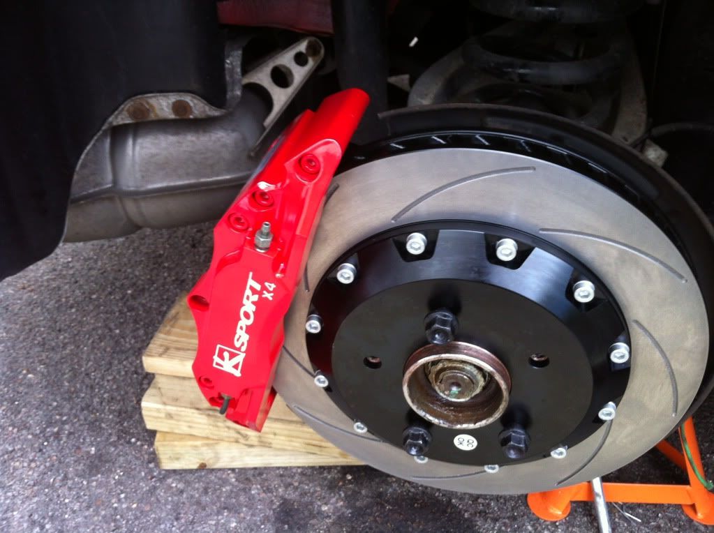

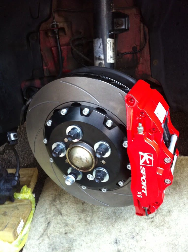

Here's a pic of the ksport with vanes and groves going in opposite directions.
You can see the vanes curve rearwards but the groves curve forwards.
Post by Sanjøy » Mon Apr 27, 2015 11:36 am
Wait a minute is the caliper on the right way? It should be on the LHS.
