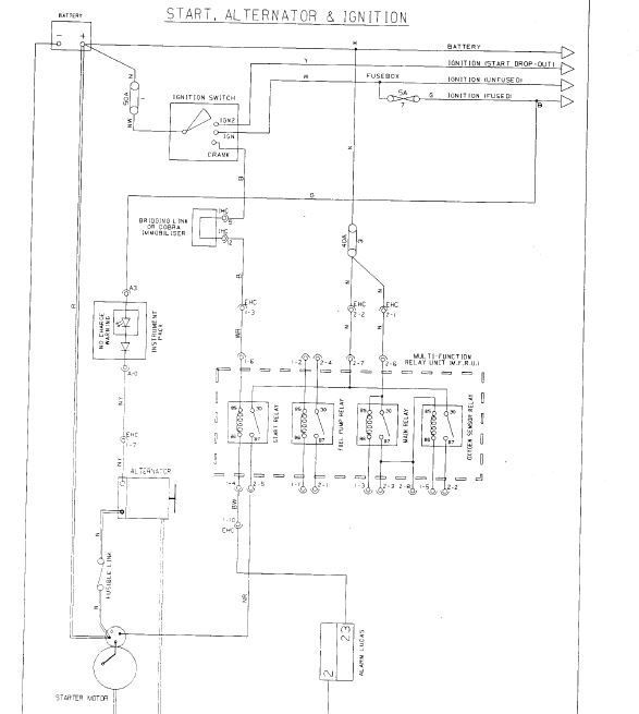

Measure the voltage from the stud on the rear of the starter motor to the engine block while the engine is stopped, then again while it is running.

Agreed. charging is completely separate to the ecu/engine running so either there are 2 different issues here, or the alternator/lack of charge is causing rough running.
Either way, you should get to the bottom of the charging issue first.
its a conventional charging circuit, switched live for excitation (thin), then a high current charging wire (thick) straight to the battery (via the starter motor post)
Check all the points for corrosion, and check there is good continuity between the alternator and the block, If the new alternator is mounted on rubber bushes then fit an earth strap.
