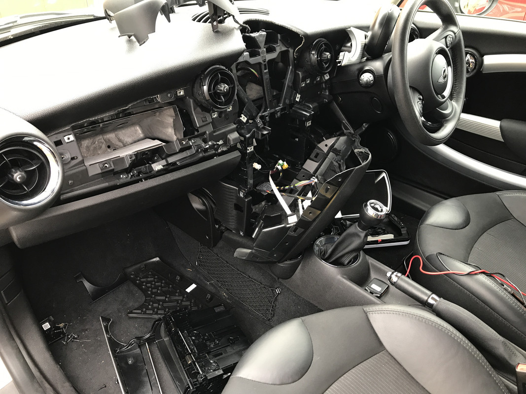

Can't help with the V6, but when I got my wee Cooper S it had the most annoying rattle that I couldn't tell exactly where it was coming from. Spent a morning taking the dash to bits, removing the big speedo, rev counter, heater, radio/CD, vents etc. Hundreds of little screws.
When I drove it with almost just the steering column left, the rattle was still there! :evil:. Couldn't trace it at all, so after some cursing put it all back together.
Then a few days later I stumbled across this 40 second clip on Youtube :roll: Problem solved! :damnfunny
Watch on YouTube
Guess message of this post is try and narrow down as much as possible before attacking with a screwdriver. :)
