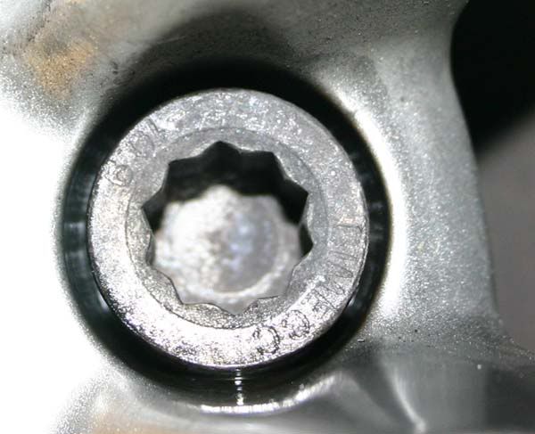

I have a small problem with my wheel nuts in that they're jammed on on the front wheels. Lotus supply a stupid star adaptor thing that snapped so I've still got a bit of that in one of the nuts. Now, I reckon I can drill out the snaped bit myself and I've ordered another 2 of the adaptors but I really don't think they'll be up to the job either.
Soooo, does anyone know where I can get a star bit that will fit? Ed reckoned it was a 13mm one and that it was impossible to get hold of and I'd need to get them drilled out but I'm not wanting to consider that yet! I've searched around and can find star bits but don't know the size name e.g.

To make it clear, all 4 nuts on both front wheels are torqued on so much that when the guys from Wheels Around used a wrench and the adaptor tool supplied by Lotus, they couldn't shift them. The adaptor sheared off and left a bit in on of the nuts so that needs drilling out, I can probably do that myself but would rather not.

Well, emailed Lotus and got the following response:
"I am sorry to learn of your wheel bolt concern.
The standard 10 spline wheel bolt key is 70mm overall length, and of
10.9
grade. Please check that it is this tool which you were using.
The spline pattern is not unique, and you should be able to purchase a
10
spline tool (not Torx) at any good tool supplier, but you would need to
check the clearance in the wheel bore for both diameter and length,
which
are dependent on the particular wheel type on your car. Please measure
this
for yourself.
Overnight application of a penetrating fluid may help."
Now, I can't find a 10 spline tool anywhere online and I don't know where else to try. Any suggestions? I'm going to call Ronnie at Wheels Around tomorrow and ask him if he has the right bit for it.

Si,
Give me a call in the morning to remind me to get you one if you need. My dad sells them and should be able to get them same day.
Alternatively get the best at snap on, link attached. Use an impact (air) gun as this will shock it loose a big bar puts too much torque into the bolt an is more likely to sheer it. Another thing is the one with the bit broken in it, try to pick it out as the broken bit will be harder than the bolt, it's likely to be as hard as the drill so drilling it will just waste the bolt.

Pic here:
Post by simon » Thu Oct 27, 2005 9:11 pm
Looks like the company that make them are http://www.bimecc.it/
So if the Lotus adaptor snaps again, I'll get in touch with them.

Si, just loked sorry but I thaught it was the 12 point spline. Bummer.
I still advise an air gun though.
