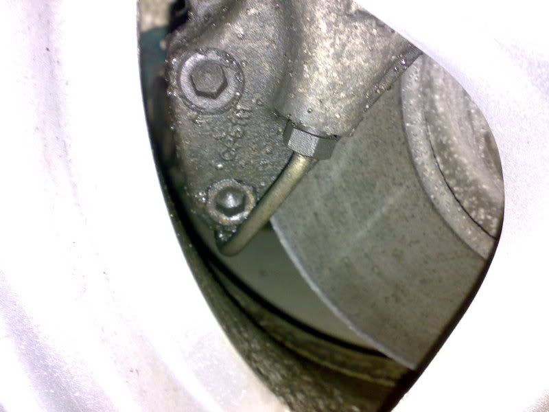

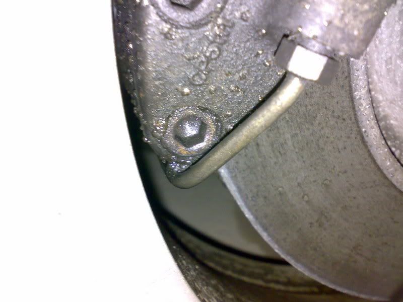

Went for my MOT yesterday and am no planning on getting the car recovered on the basis of the brakes being dangerous, do you think it will be covered by the AA P&L?
OSF Brake pipe leaking at caliper

Leak looks like it is a the 90ish degree bend and has rubbed on the caliper.

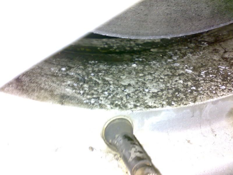

Corrosion on wheel from leaking fluid :( :(

Post by Rich H » Sun Mar 11, 2007 9:05 pm
Are you sure the pipe has gone through? Get someone to stand on the pedal and watch for leaks (Not too close though!) The pipe is the link btwn the pistons and is rigid, it's only about 4" long so no real chace of chaffing. Could be a rock or someone clonked it while the wheel was off? Try nipping up the joint above it. It could also be a leak form the caliper itself. I don't know if there are spares available or the calipers though. deffo not from Lotus but perhaps something else like.
Failing that and assuming that you didn't know about it, clean it all up tighten everything and see if it comes back. French chalk dust is good for mopping up brake fluid BTW.

Post by Sanjøy » Sun Mar 11, 2007 9:58 pm
Will try cleaning it up and have a better look
