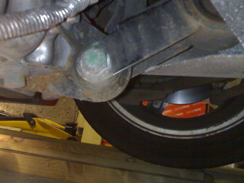

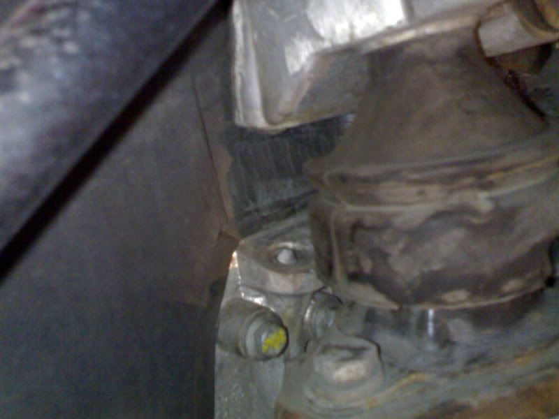

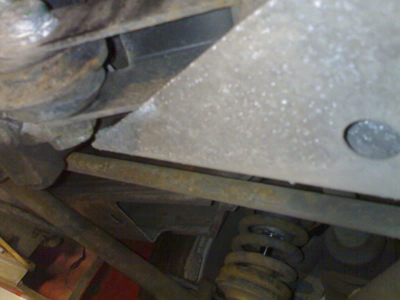

Post by r055 » Fri Apr 06, 2007 10:12 pm
had a good look tonight underneath the car...
im not so sure this bracket should be so far down... anyone?
The exhaust flexi was slightly poking through the undertray before i had taken it off.
The right-hand upper mount doesnt look out of place (i think :? ) but the left hand mount looks like the rubber has deterioated...
Can any one help?!? :?:

thinfourth
Posts: 3177
Post by thinfourth » Sat Apr 07, 2007 6:13 am
That right hand side engine mount looks proper fcuk
And it looks like the lower linkage is hitting the chassis I would say replace both as a precaution. I would also be hesitant to take the car out until its fixed.

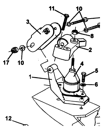

Post by Rich H » Sat Apr 07, 2007 7:12 am
Looks like the gearbox mount is fecked and then the other end may well now be fecked too...
the two either end are rover items the middle one is Lotus. Simon has the sump mount spare from what I remember.
You need the top two in this picture I reckon. Or at least the top right £20+VAT:
Post by robin » Sat Apr 07, 2007 7:47 am
The bar that is touching the subframe should be more-or-less horizontal.
The gearbox end mount might well be gubbed, but only the drivers side engine mount could cause this problem I think. I would guess that the two 18mm bolts that hold the engine mount to the chassis mount are not present, or that the mount has sheared.
I would be surprised if it's the rubber itself because failure would still leave you some support.
If you can be arsed to remove the right hand rear wheel arch liner you could take a photo.
Alternately, point your camera into the wheel arch from the exhaust side at about a 45-degree angle - in case you don't know what you're looking for, you are trying to photograph the thing that protudes from the cam-belt end of the engine into the space just above the chassis.
Post by Rich H » Sat Apr 07, 2007 7:54 am
How do you get pics form the service/parts manual? I'm computer incompetent....
/thread drift...
Isn't the big mount filled with fluid? Could this have popped? It could explain the gradual failure.

Post by robin » Sat Apr 07, 2007 9:22 am
In acrobat there is a wee camera icon - it lets you select an area of the document and copies it to the clip board. Then run mspaint and paste in the image; edit, trim and save as .PNG, then upload to photobucket or whatever.
I didn't know it was fluid filled, but it could be!
It may be that it has collapsed, but it's hanging so low I would suspect a more serious failure - anyway, either way it's the drivers side engine mount that's broken!

Post by r055 » Sat Apr 07, 2007 10:49 am
AhHHHH! Just buckled the lock nut key and broadband line just went down. Off round to rover dealership hoping they are in today
Post by r055 » Sat Apr 07, 2007 12:03 pm
right, just back in from rover parts dealer to get a new lock nut key... sigh.
managed to get the wheel arch liner off and have found the source of the problem!...
the mount has sheared and engine is hanging down a good 2 inches more than it should be :shock: :?
does anyone have a spare right-hand side engine mount they would like to sell me?!? - willing to travel anywhere this weekend to pick up.
i would probably be best replacing all of them, eh?
