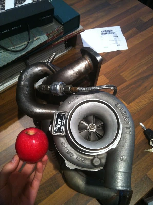

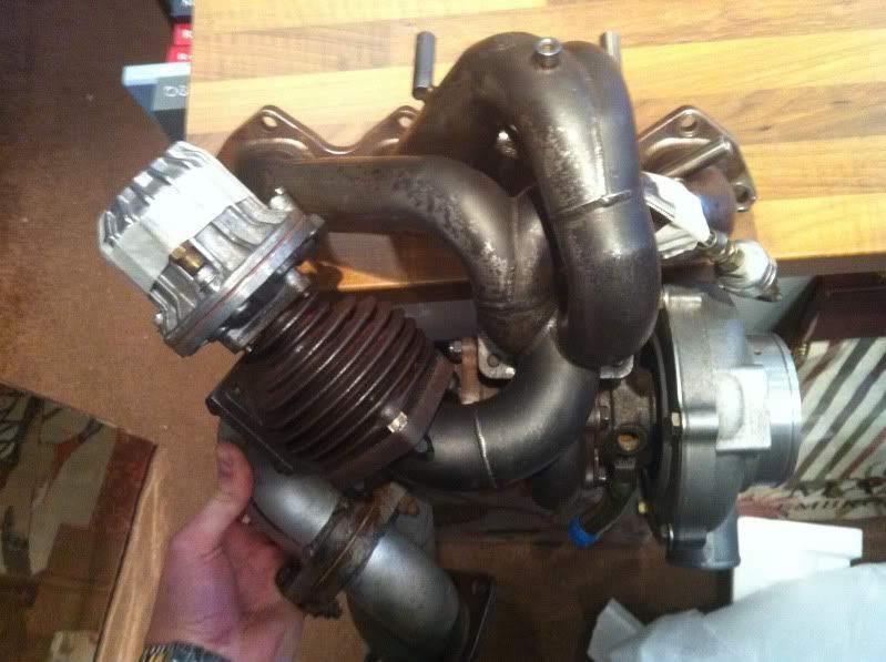

turbo/manifold/wastegate arrived, decided against the FP Green so I will be able run higher boost without worrying.
HKS GT3037S, from what I gather its a GT3076R in HKS clothing
Its rather large :lol:

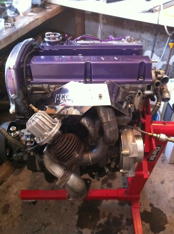

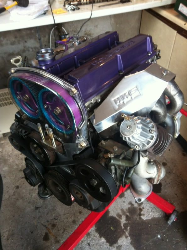

Ready to go in tomorrow -
