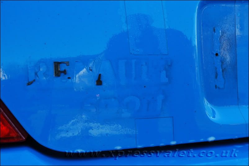

Firstly Colin had decided to remove the stripes over the roof and bonnet etc leaving glue strips on paint, and also got the bonnet and front bumper freshly painted prior to the car coming here. So, the decision was to go for it big time on the other panels and take it nice and easy on the front end.

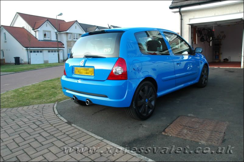

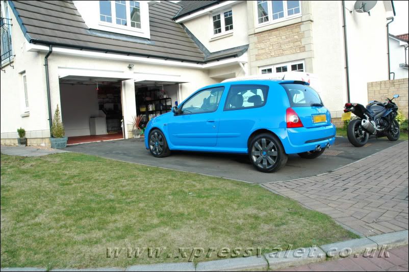

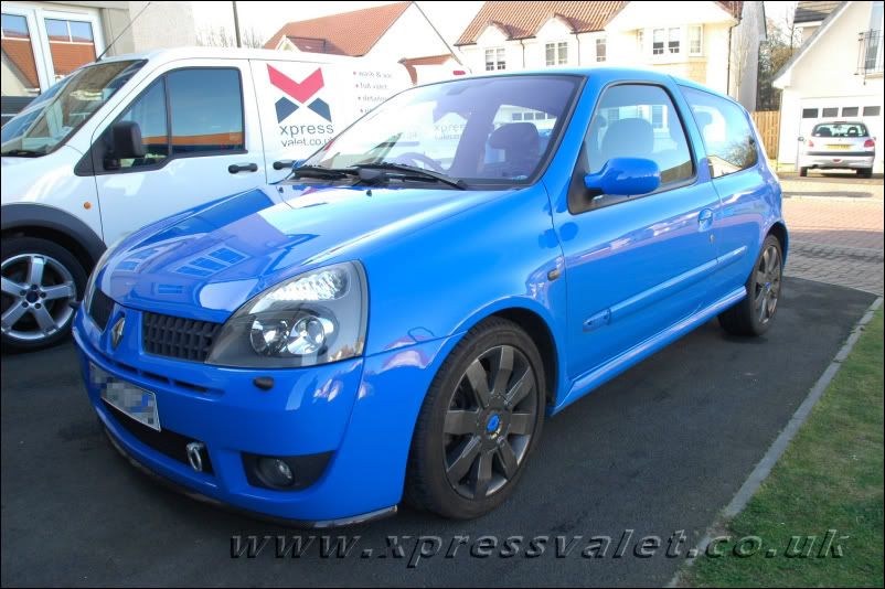

on arrival the car didn’t look too bad, the body shop had given it a wash ( haha )

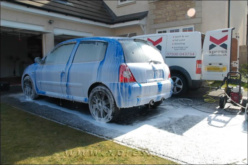

Prefoam:

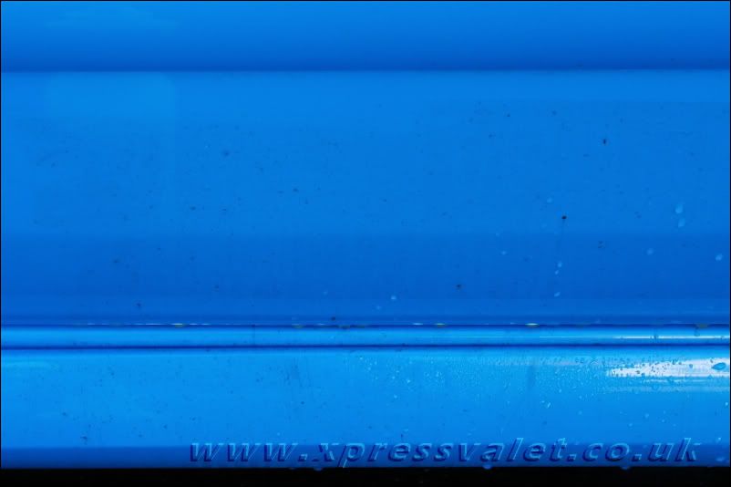

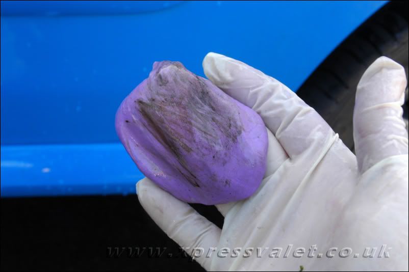

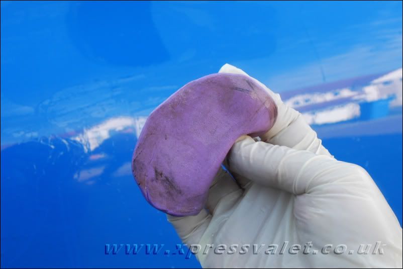

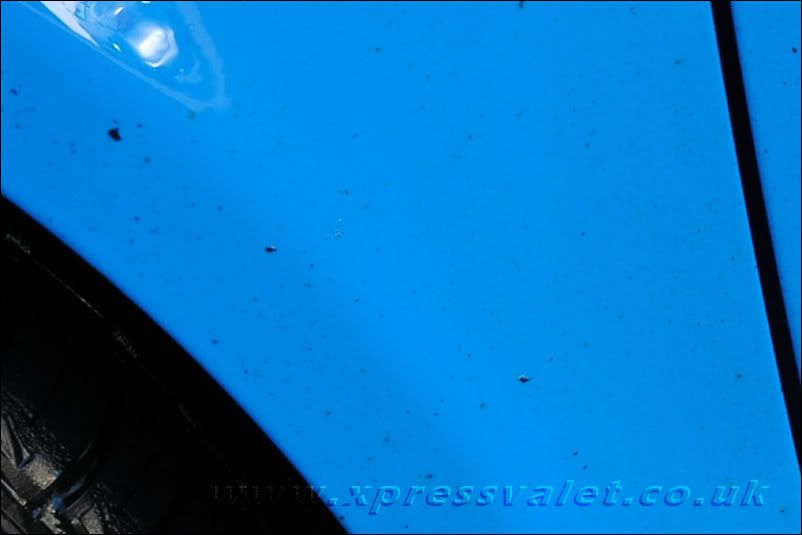

Rinsed with PW and then inspected. this car is by in far the worst condition i have ever seen for tar spots, the boot lid and both sides were covered.
the areas were treated with TAR & GLUE remover and MF cloth to try and shift them, but that was not doing the job 100%
These areas where clay'd using an aggressive clay and MEGS QD lube.

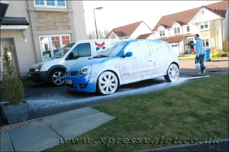

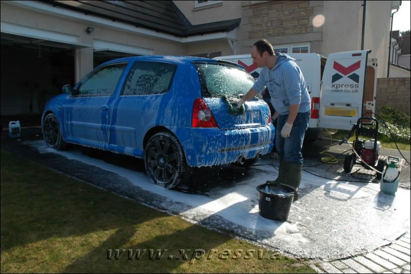

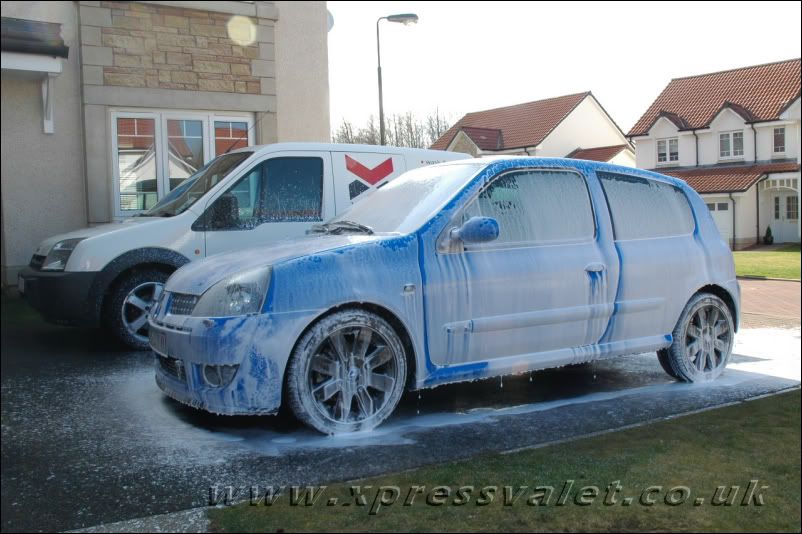

Another foam:

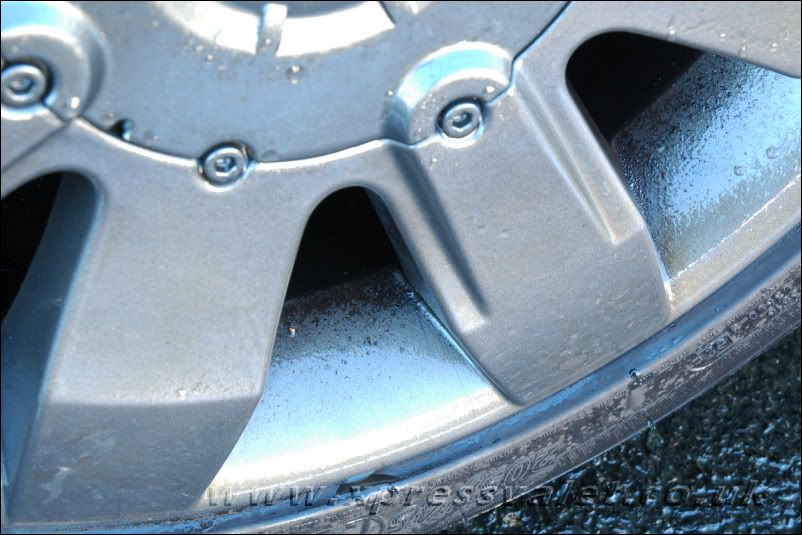

This was left to dwell whilst the wheels got a little going over:

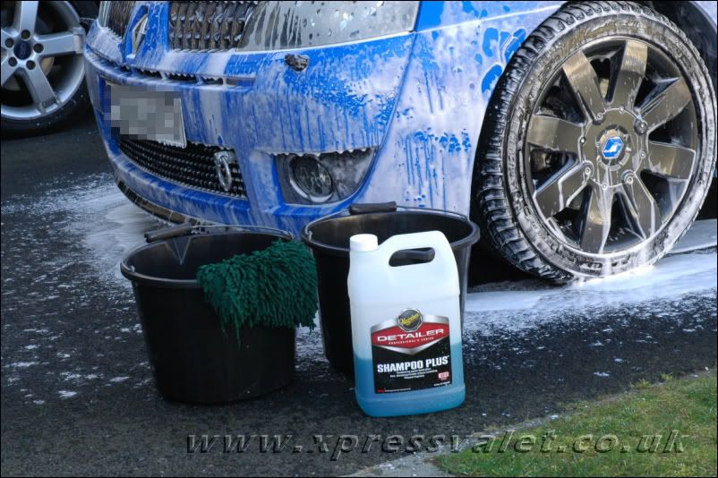

The paint work was now washed:
rinsed by my assistant for the day "dodo-dean"

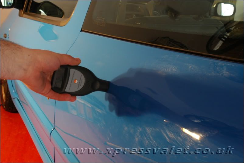

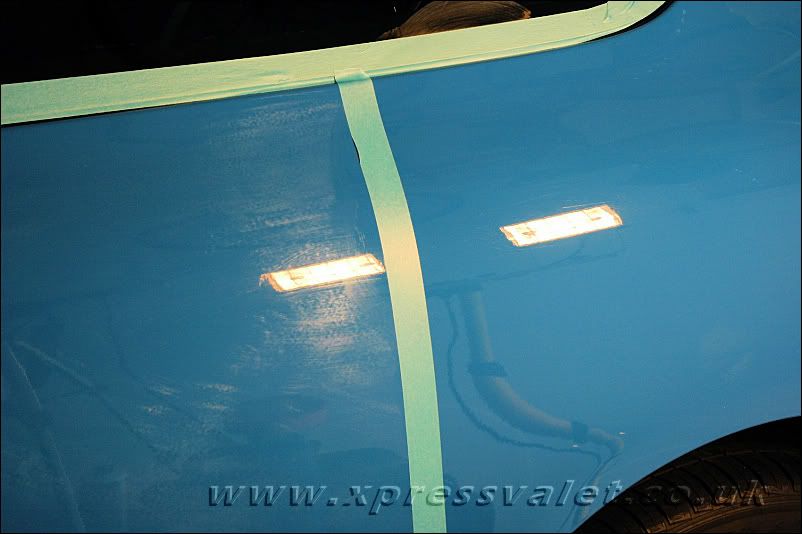

Into the garage for paint inspection and taping up prior to machine polish:
Paint levels proved safe all-round and only told us what we already knew that the bonnet and front bumper had been re-painted.

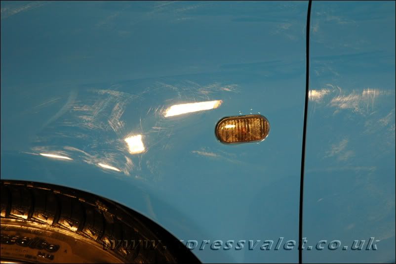

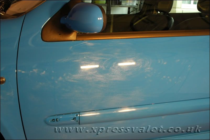

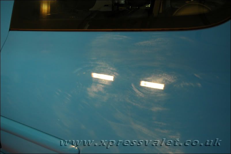

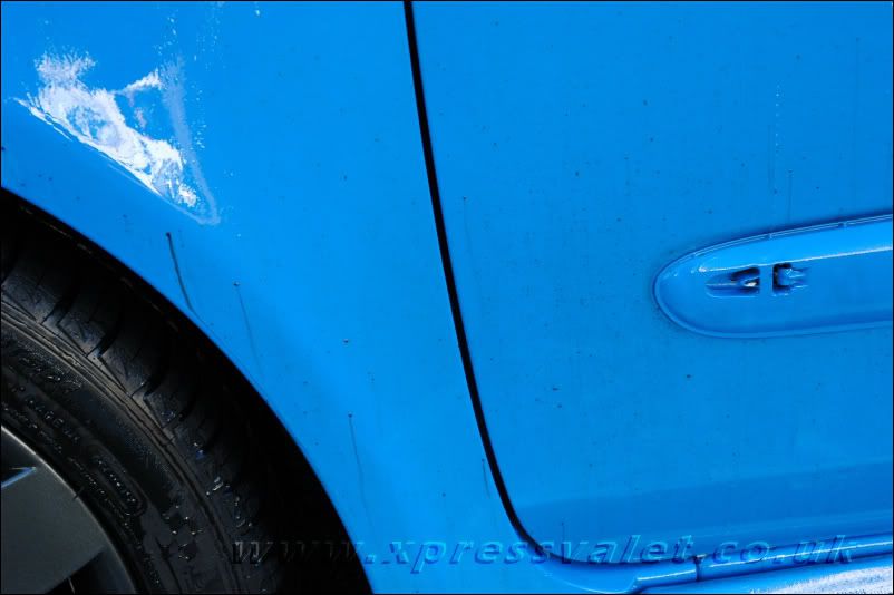

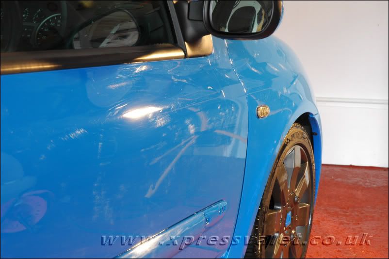

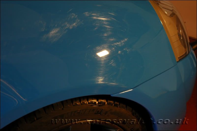

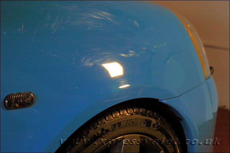

Some shots of the car before showing paint defects already present and some mild marring by the clay process:

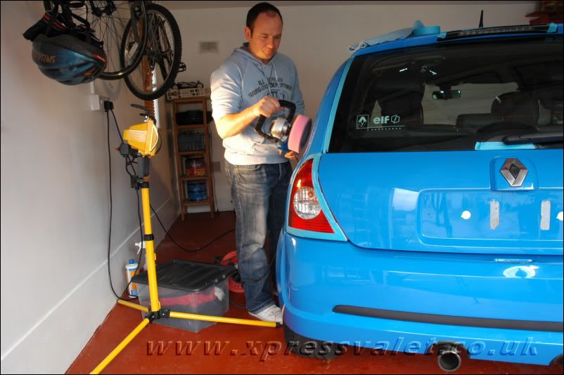

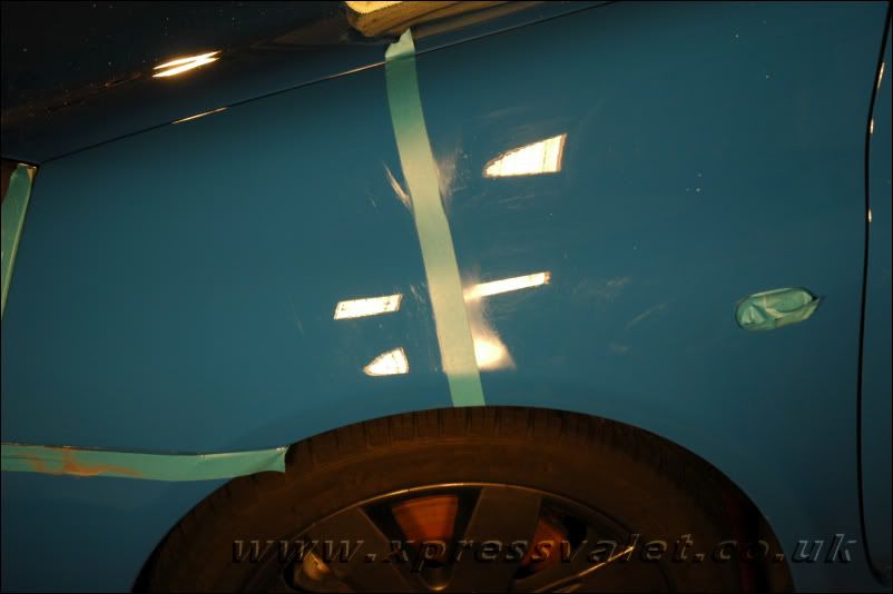

taped up and ready for action, menzerna 106 and 3.02 needed:

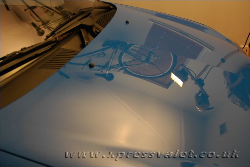

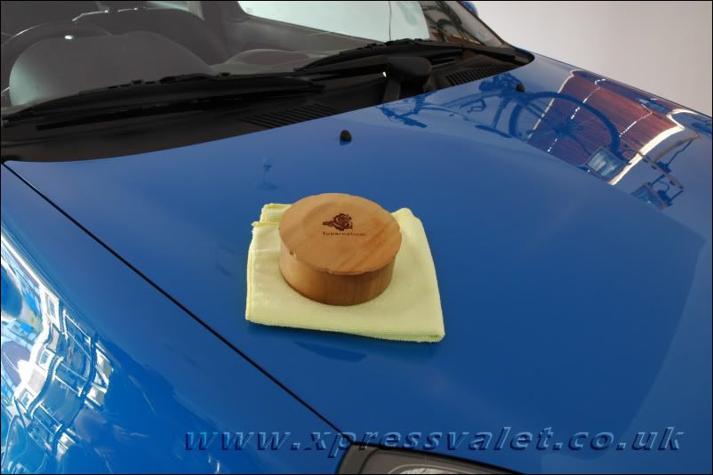

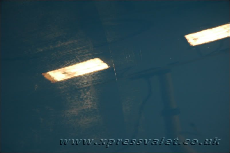

The bonnet had Blackfire Gloss Enhancing Polish (non abrasive) applied with the makita at a slow speed due to new paint.
this was the level of correction after a couple of passes. Another pass took out the remaining swirls

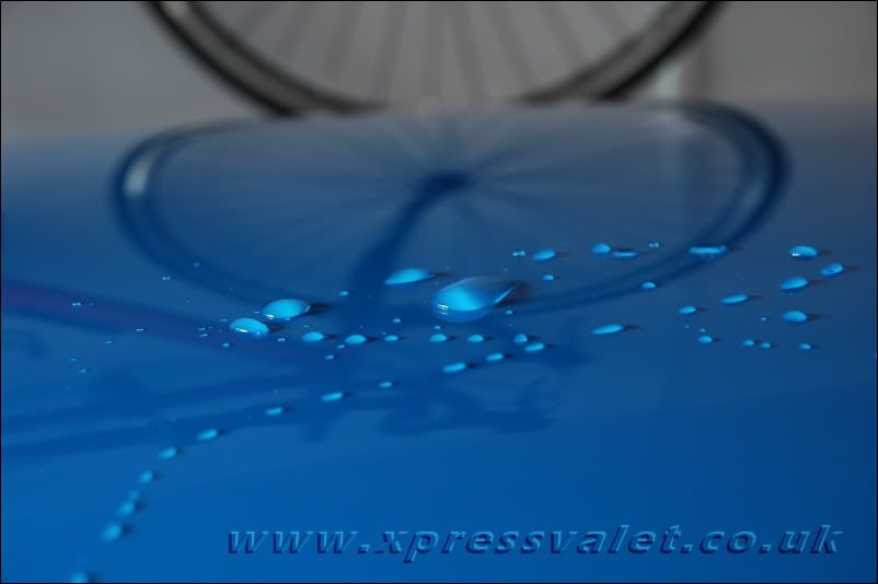

The LSP for today was with a premium carnauba wax, this time it was DODO JUICE SUPERNATURAL WAX, expertly applied by "dodo-dean" :

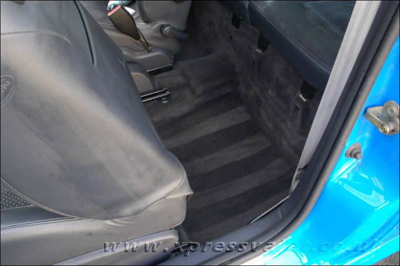

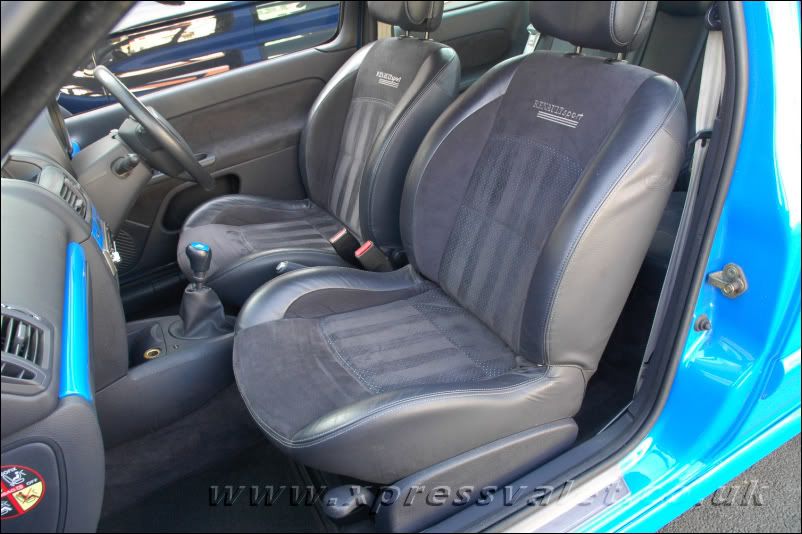

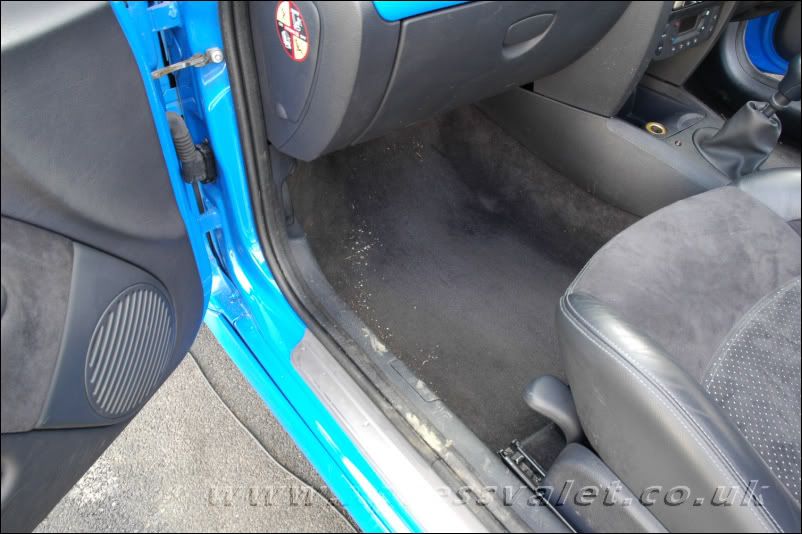

The interior got a little tidy up too, b4:
after:

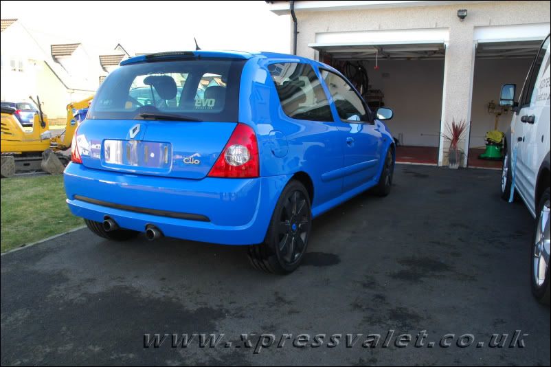

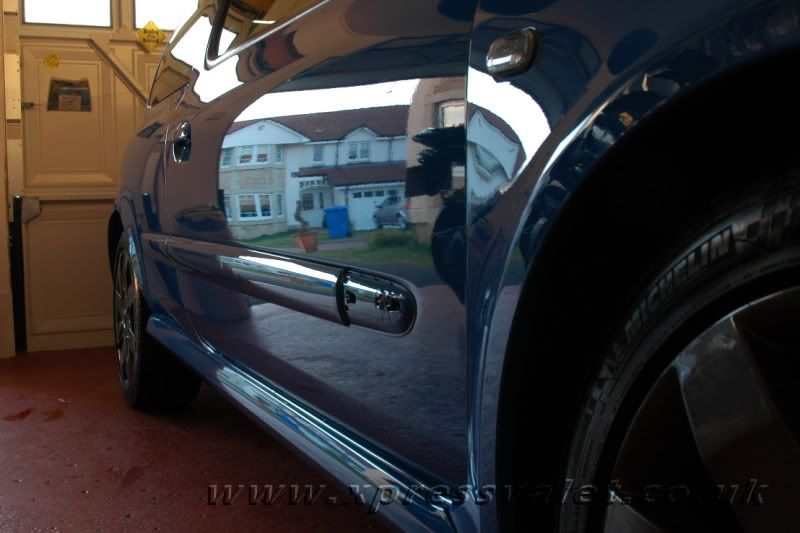

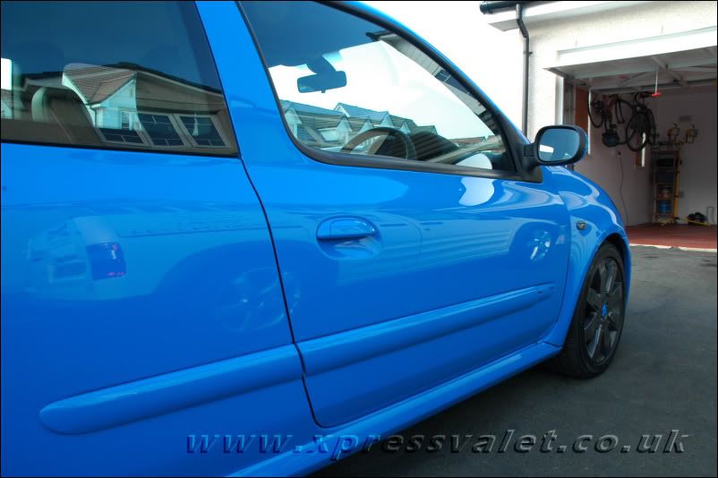

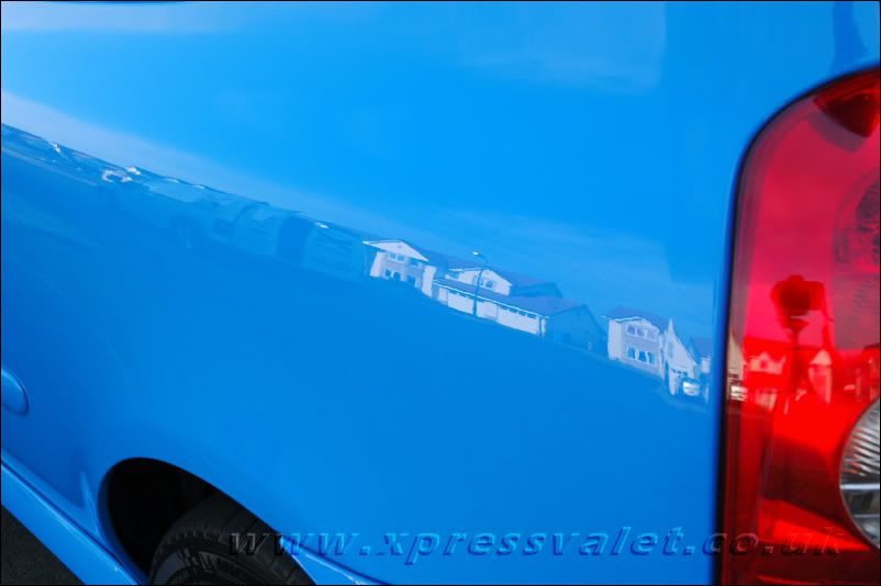

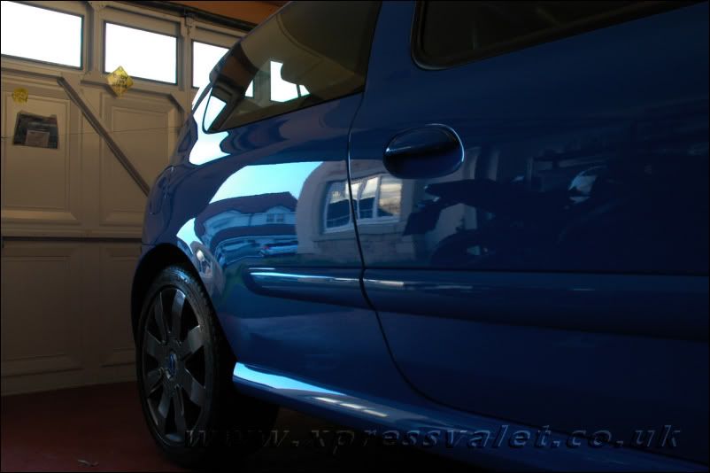

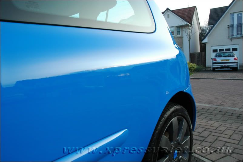

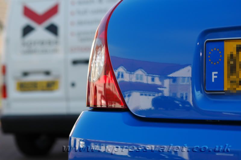

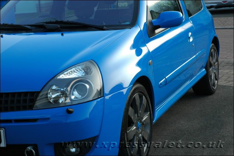

And finally, what we all want to see, the results:

Great work Robert :thumbsup I particularly like the before/after shots with the lights and the masking tape line for a 50/50 !! 8) Great write-up too. I take it you are a regular on Detailing World?
