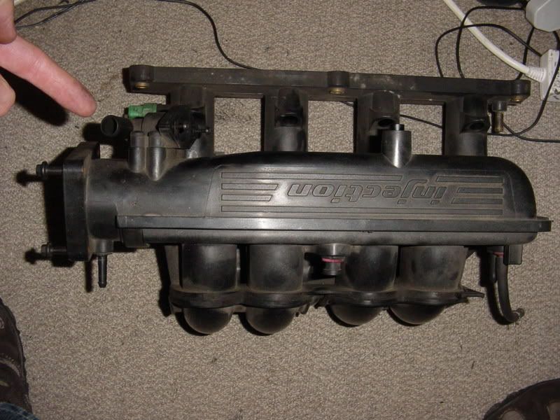

craigs135s wrote:it was a plastic one that was on it. Only thing is the tb is closed fully and its still at 3 rpm is that right?
Craig
check the throttle stop (screw) if not did you replace all the vacume hoses from the pellium and the breathers, look for a air leak
is it sealed ok ect sospect its drawing air in from someware

thats what my mate thought as well but cant see where the air would be leaking from. All the pipes are fairly tight.

Tryed covering the holes and its still reving its head off. Any other ideas or will i jsut put the old one back on.

Post by Rich H » Fri Sep 08, 2006 1:35 pm
To clarify things:
The engine idle speed is governed by the IACV. If you pull off ht epipe and stick your thumb over it the engine should die (Take the bigger pipe off and cover the engine end not the TB end) If it doesnt then there is a serious leak somewhere as it's getting air from somewhere.
Check the MAP sensor is attached, the fuel pressure regulator is plumbed in and there is a black bung in a red collar in the top cnetre of hte manifold (if plastic) Check the manifold is tight to the head and there are no obvious leaks.
When you say the throttle is closed is it hitting the stop or is it physically shut? There aren't any holes in the butterfly valve?
You mention a big square hole, are you sure this is blanked off properly?
Post by Rich H » Fri Sep 08, 2006 1:40 pm
A pic, the finger(!) is pointing at the IACV pipe you need to block off. On the other side is another vacuum pipe that should be fitted. On the other end is the MAP sensor pipe and the FPR pipe should both be attached and leak free. the Red bung is in the centre and just pushed in.

sorry Rich whats the IACV?? :lol: realy not good at this tec stuff.

Post by craigs135s » Fri Sep 08, 2006 1:47 pm
sorry posted that before i seen your pic. rite will go and have a go.

Post by Rich H » Fri Sep 08, 2006 1:48 pm
Idle Air Control Valve. Follow the finger...
It is a motor operated bypass valve notorious for being rubbish and gunging up with greasey mess. Pull the pipe off and stick your thumb over it. If it dies the IACV is bunged up with crap, if it don't then the throttle butterfly is open or you have a leak.
The IACV is held in with mini torx bit screws and then just pulls out. The end should be shiney steel, yours (Like mine!) will be manky as hell.
craigs135s
Posts: 1960
Post by craigs135s » Fri Sep 08, 2006 1:55 pm
ok mate pulled off the pipe and coverd the hole where you finger is the revs droped to 2 rpm but did not cut out. So i must have a leak yes?
Craig

Post by Rich H » Fri Sep 08, 2006 4:23 pm
Right I have a similar problem it would seem, I think that it is because the throttle cable is very long and draggy so the spring isn't quite up to closing the butterfly totally. It looks closed and is on the stop but a slight tap closes it and the revs drop. I have backed off the stop screw a bit more and it seems to have worked but IIRC yours only has a spring on one side.... Might be worth dismantling it all and putting another turn of preload onto the spring so the butterfly snaps shut a bit more positively. This *may* help.
With the IACV shut off and it doesn't die then you have a leak....
Rich

Post by craigs135s » Fri Sep 08, 2006 10:13 pm
all sorted cheers rich. The butterfly wasnt shuting all the way. Ajusted the screw moved it back and forward a few times and wallaaaa we have 1rpm again. Thanks for your help on this one mate.
