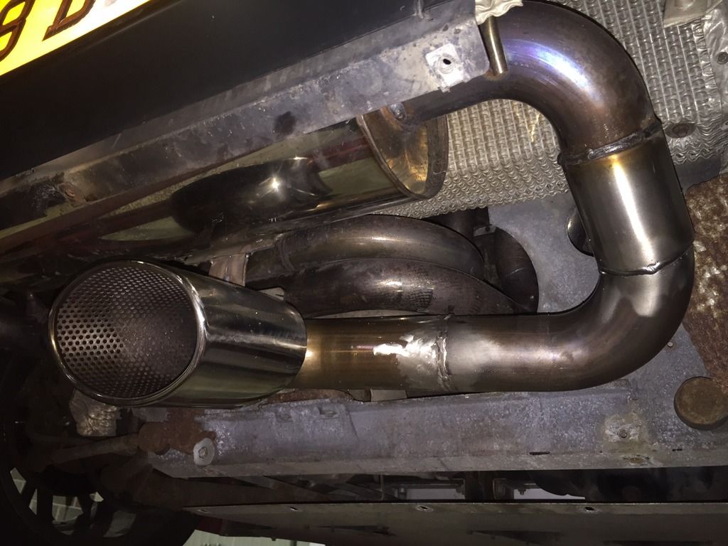

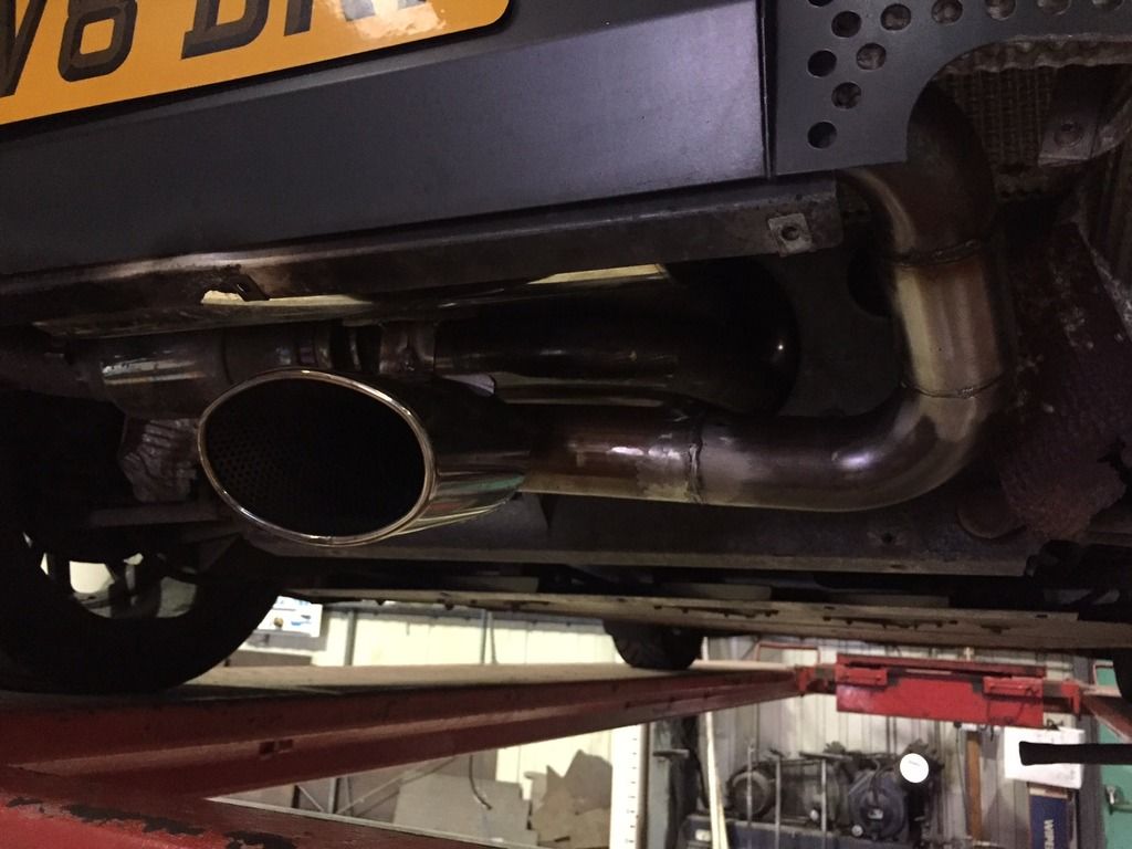

Sorry - meant to post these pics ages ago.
1st pic is when Craig fitted the brand new Janspeed - it didnt fit properly because the exit pipe swept round the back and hit the stainless manifold as it branched round the corner.
I done a track day down at RAF Marham & got 145mph down the straight (1.5 mile runway!) and warped the undertray - as the heat was going both sides on the tray.
I took it to RJM over in Glenrothes - they cut & welded it to suit.
Cost me £120
Much happier with the way it sits now (need a new under tray now!)
