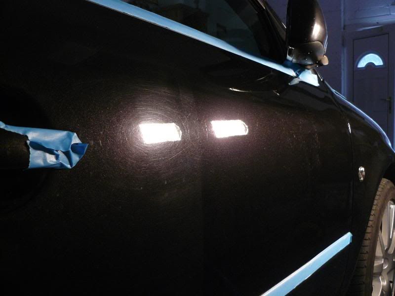

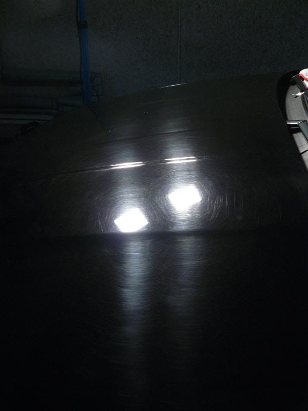

I bought myself a DAS 6-Pro (a random orbital polisher) kit with pads and Menzerna polishes so I could have a bash at Machine Polishing.
(http://www.cleanyourcar.co.uk/polishing ... d_675.html)
Bearing in mind I would win the prize as the person least likely to use hand tools and have the attention span of a goldfish, I have to say that the transformation was pretty spectacular.
Befores
And after about 20hrs of slow going...

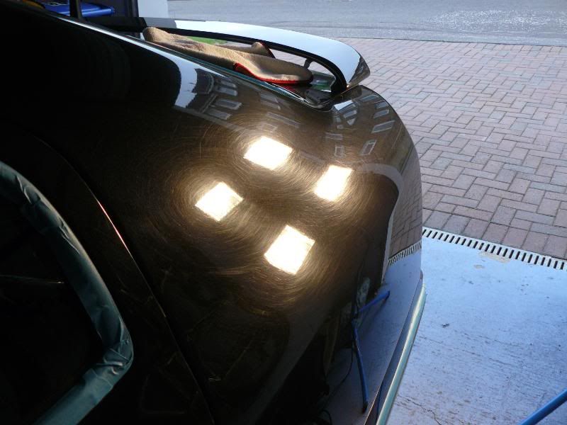

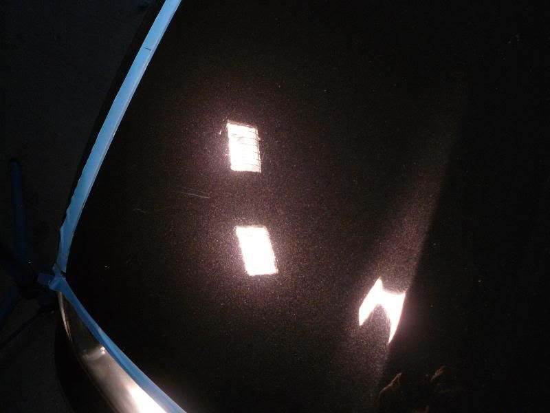

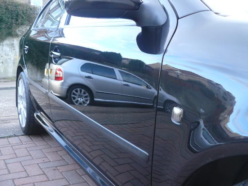

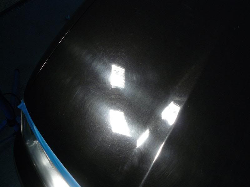

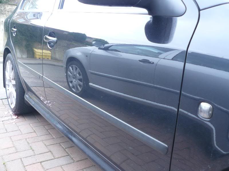

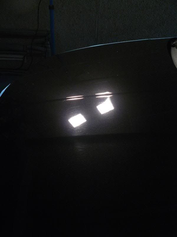

I've also got a DAS-6 with the Menzerna polishes. I even went on a days course to learn how to use the thing!
Results can be pretty stunning, I spent about 12 hours on my mates 120k mile Octavia which had been washed with wire wool by the looks of it.
The results speak for themselves;
That result was with just one stage as well. If I'd had more time I probably would have gone with a more aggressive polish/pad combo to start with then refined it with a finishing polish but as it was I removed about 80% of the defects in the paint and left it nice and shiney. The owner was happy anyway!
Got my brothers new carbon black M3 to do next- had a play with a panel at the weekend- that's going to be a tough job!

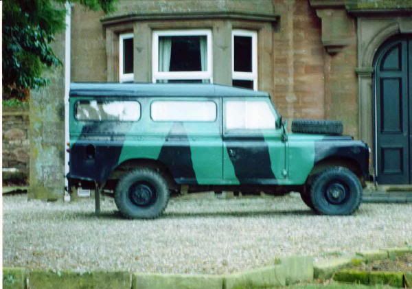

Haven't used the most aggresssive polish. I will probably have a try with that on the landrover.

tuscan_thunder wrote:S500 will be very aggressive on a Land Rover: not sure what model you have but from 1996
!979. Trust me on this.... it ain't possible to use anything too aggressive on this thing.
If I could get a spinning Brillo Pad it would do more good than bad :blackeye

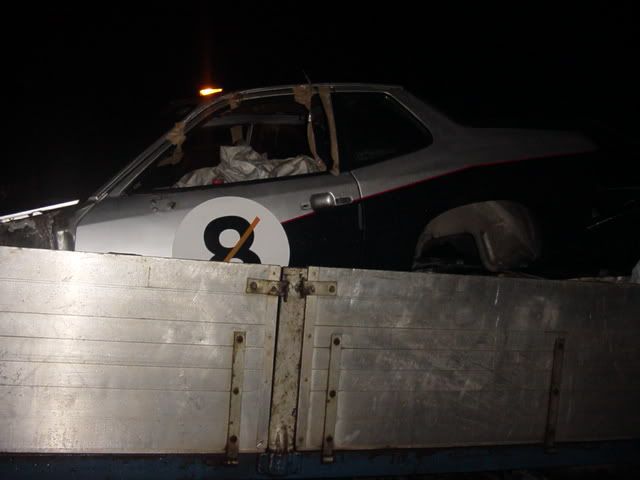

Awaiting a post from Rich to say, 'ah stuff it, a few cans of aerosol paint works out easier so went for the re-spray option'. Now where's the piccies of the silver and red porker? :lol:
Re: A new experience....
Post by Rich H » Wed Mar 09, 2011 3:12 pm
This one? RIP:
That's why I need help...!
