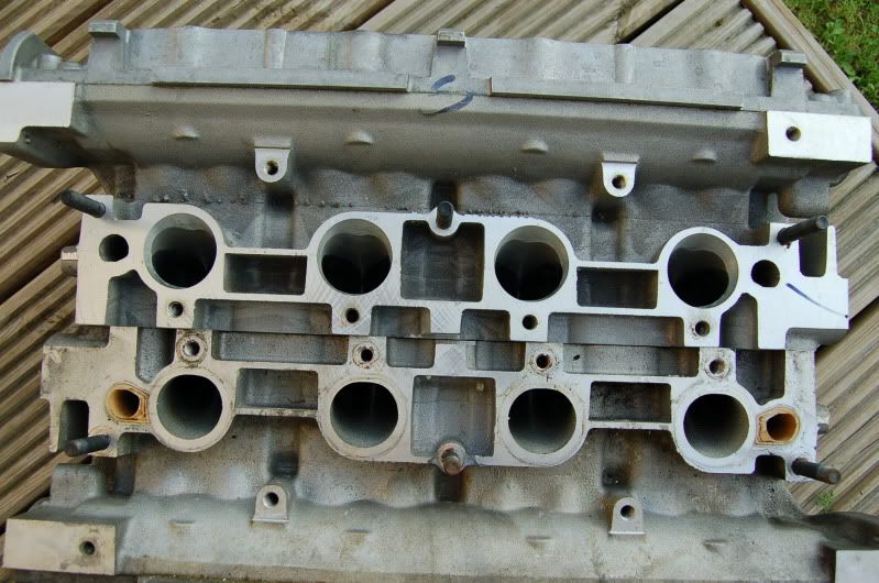

Is it a lotus or aftermarket 135 head you have Dave?
The alloy plenum was designed for the VVC, which has larger inlet ports, and a larger dia. at the inlet opening. When you fit an alloy plenum to a head with standard inlet openings, a step is created between the two; not good for flow. The head opening can be, er, opened out to match the alloy inlet.
Was just looking at the port matching on a 160 head Vs a standard one last night, can get a pic to illustrate the point later. I suspect your head if ported with the standard manifold in mind, will be similar to the 160 mods, but without the opened up ports mouths.

Post by woody » Sun Jul 03, 2011 8:23 pm
A bare 160 head with port matching Vs a fully standard casting at the bottom.
