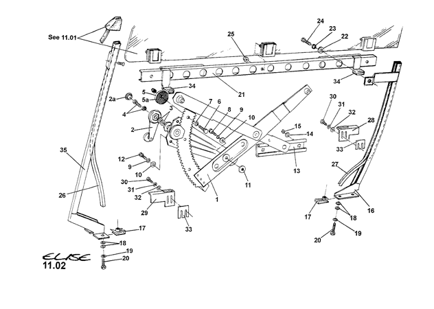

Is this a common thing? Window has fallen down inside the door :(
Not got any tools at work but will have a look when I get home, I assume if I remove the black plastic panel on the inner face of the door I'll be able to get to the mechanism?

Yes and Yes.
There's a clear plastic membrane in there glued on to keep the water mostly out of the cabin. You can pull this away without destroying it though. The window will have come unbonded from its three tabs that secure to the winder mechanism. There should be a wiki or something online somewhere to detail fixing, but it's a pain in the hoop. Also be prepared for extensive laceration as every bit of metal in there is razor sharp.

Exactly what Shug said. Done it myself, not sure I could be bothered doing it again.. would pay a man if there's a handy one near you. By the time you've bought the proper bonding glue online, and lost your knuckle skin, and sworn your way through an entire Profanisaurus, you'll probably agree.
(N.B. see winder handle position on that schematic... That's viewed from the outside of the door, which is the back of what you'll see when you take the inside cover off. Very useful, Lotus, very useful.)
Three tabs aren't numbered on that pic, but they're the u-shaped square things on the bottom edge of the glass, and hold it to rail 21. They're just glued to the glass with something crap like Playskool PVA, or Dairylea Spreadable or something, and it fails on all S1s at some point.
