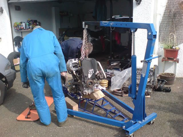

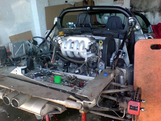

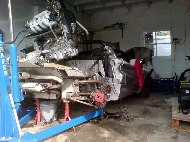

A lot achieved over the weekend...
From here on Saturday:
....to here by close of play Saturday....
....to here, and up and running yesterday afternoon....
Nice to catch up with everyone too! :D
Ross.
