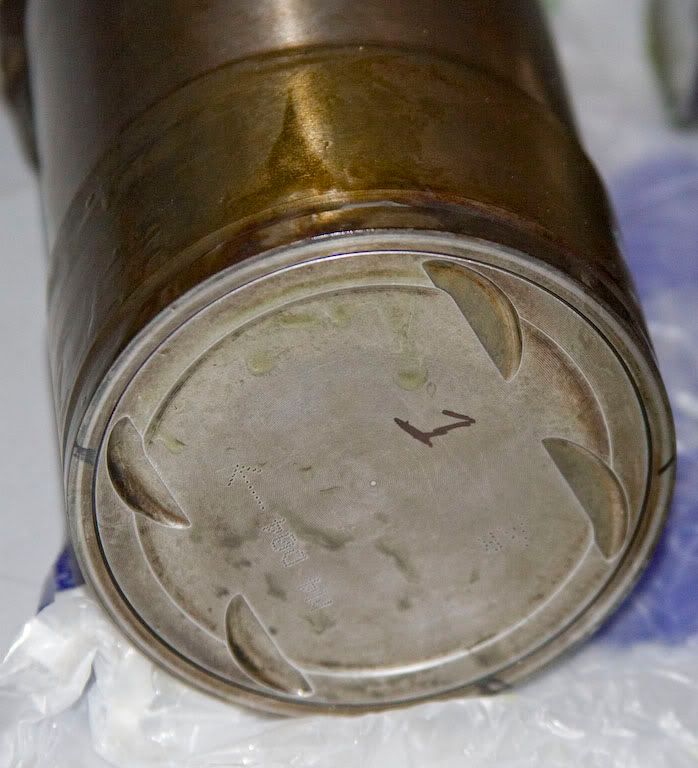

I would have left the molycote as per the first pic though; it shouldn't need buffed off.

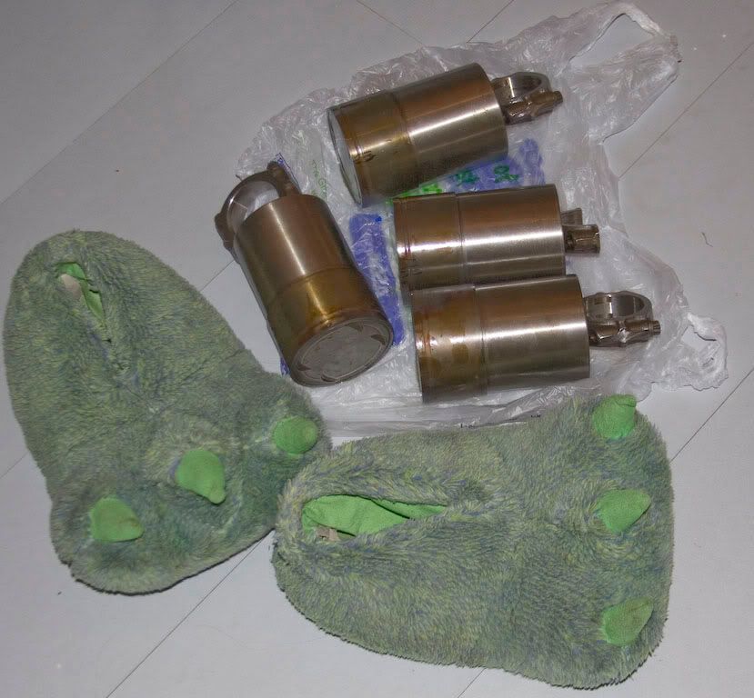

Sock drawer Robin?? Come on, give me some credit please.... They're tucked up nice and warm with my slippers

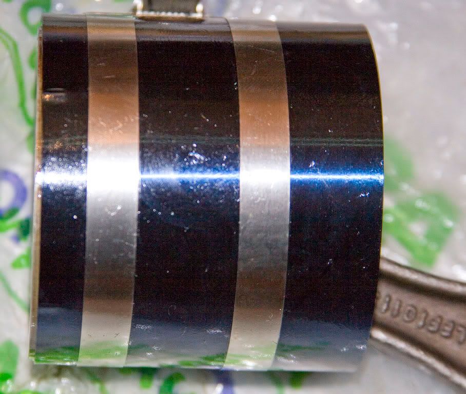

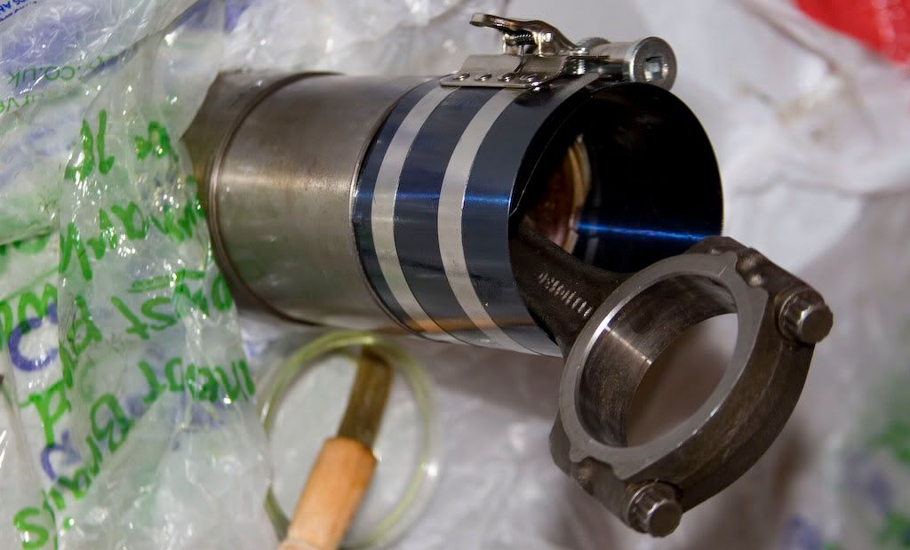

Right, got a few more things done now....
To fit the pistons into the liners, the rings need compressed to fit into the bore. The piston's installed into the ring compressor which is then tightened up to the size of the piston. A little bit of piston is left (you can just see it on the left) to help engage it with the liner.
Once it's lined up, push it in firmly watching out for rings escaping free from between the liner and ring compressor.
And it should look like this when finished
Then return all 4 to the company of slippers

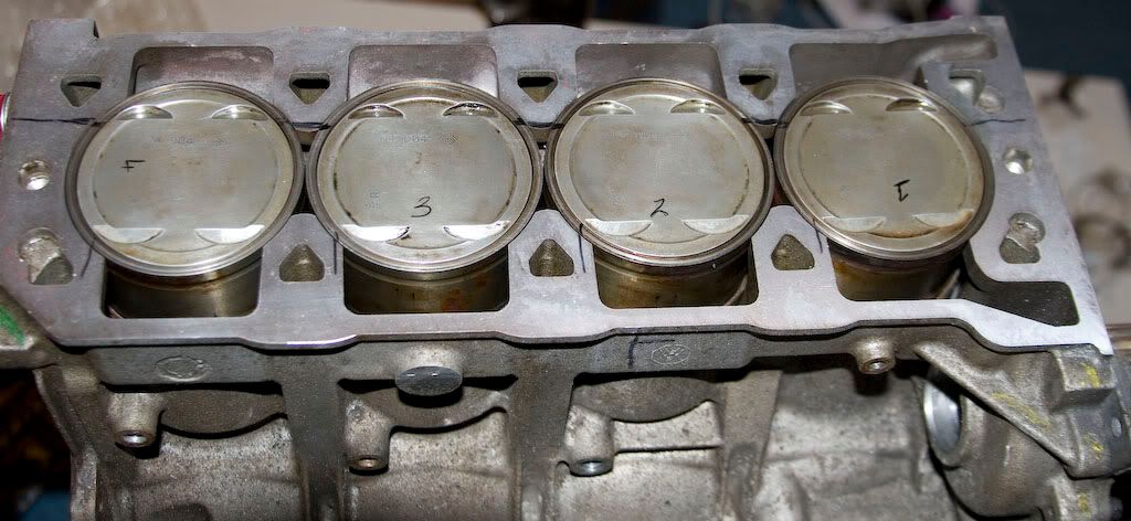

The above photo shows the liners and pistons test fitted into the block. When Stu machined the block for the liners, he made reference marks to indicate their correct orientation. Once the marks on the block line up with the marks on the liner, the piston is rotated to its correct orientation to engage the big end bearings on the crank. I'm doing this now, as i dont want to be messing about with this when i've got the sealant on the liners... Messing this bit up is NOT an option!

Nice slippers!!!!!
