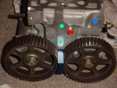

Post by Rich H » Sun Jul 30, 2006 10:21 pm
My head isn't drilled for a manual tensioner. Is it worth drilling some holes? or stick with automatic?
Rich

Post by Rich H » Sun Jul 30, 2006 10:35 pm

Post by Lawrence » Sun Jul 30, 2006 10:49 pm
ah!
the holes will be on the block then :)
Post by Rich H » Sun Jul 30, 2006 10:55 pm
Blue is where the tensioner goes, red is the auto, green is the manual (That aren't there...)
I can drill the holes no probs but is it worth it? :scratch
Lawrence
Posts: 1017
Location: remembering Dijon
Post by Lawrence » Sun Jul 30, 2006 11:15 pm
Well if you can drill and tap them do so and then make the decision as to which to use later.
Post by Rich H » Sun Jul 30, 2006 11:36 pm
Is there a real advantage to the manual tensioner? Do the auto's fail?
