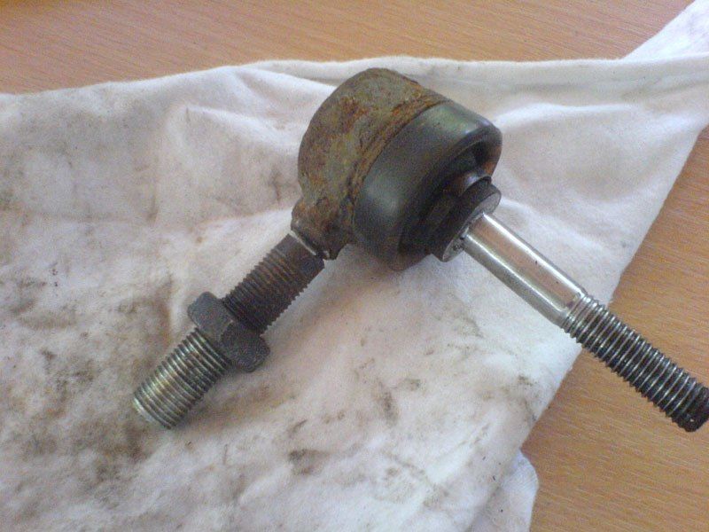

Sorry about the picture quality but here is the offending item.
The problem is that the bolt is under rotational sheer at both ends, as are the standard ball joints.

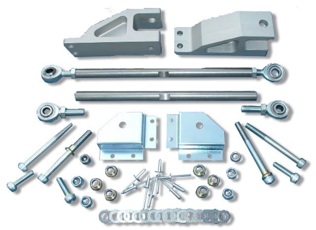

The eliseparts kit is like this
The point Shug raised is that the inboard strengthener needs to be rivited on and is a box section I would have thought that a triangular piece of plate sloping to the cross member would have been better. Without some additional support the inboard ball joint/bolt can fail.
There are also issues with the alloy hub carriers and bolts failing on the outboard end unless the added support is used to put the bolt in double sheer. The metal hubs don't fail but the bolts/ball joints do.

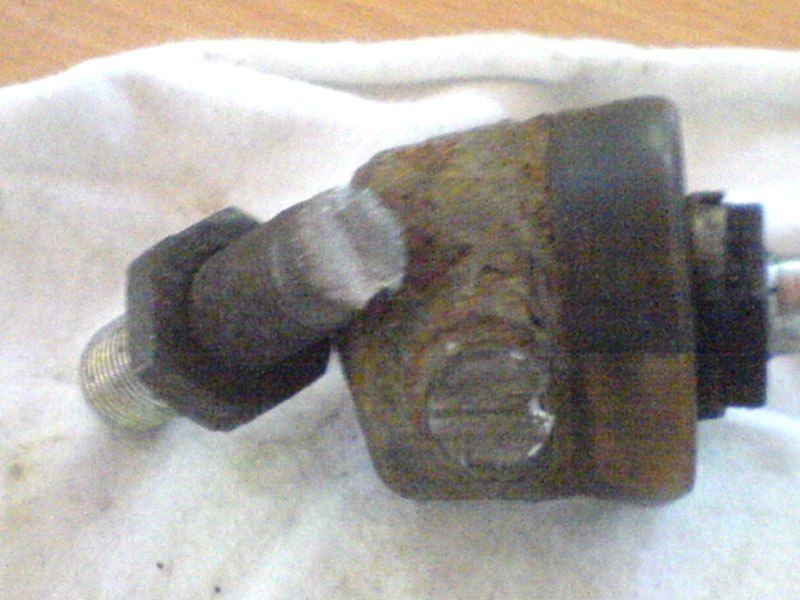

It was the actual thread that goes into the bar that broke. Snapped clean just after the body of the ball itself. There's no rose joints here, remember.
The bolt that goes through the wishbone was Ok.
Wish Shug could take some pics, he's got the bits.

I thought it was the ball stud that broke, as per the picture samjoy has posted the link to. I'm surprised that the thresded stud that goes into the toe link would snap as there should be only push/pull forces there.

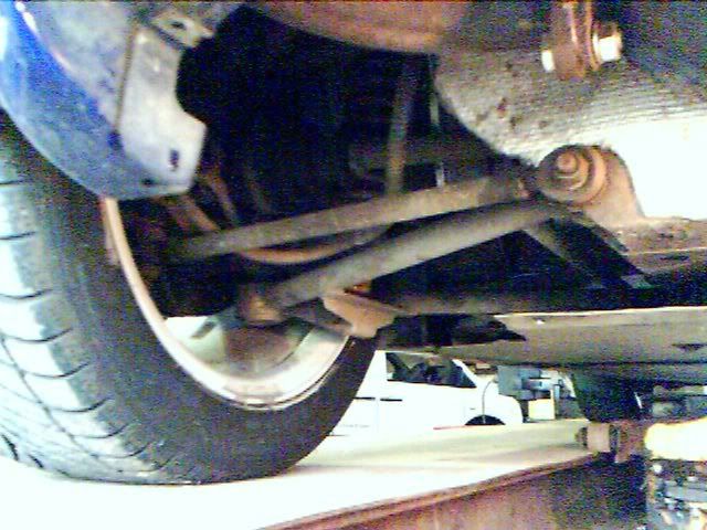

Anyway - there's a couple of pics of the offending item. I figure the balljoint seized solid (this must have been pretty quick, as it wasn't noisy and I'd checked the suspension before leaving - it was jacked up and moving fine)

Balljoint has seized. I know this, as I can't move it (with WMDs) That's maybe a heat issue, not a grip one, but it broke under load, on a bumpy, fast corner.
Think the point is that they are under specced for everything the rest of the car can do. So, they go in the bin and rose joints get put on. There's plenty of racing elise/exiges using the currently available design of uprated joints - so I'm gonna go for that just now. No doubt a better solution is possible, but it's not available just now and I'm not in the mood to be a guinea pig :wink:

IIRC one of them is prone to overheating due to the zorst, which side was it? It may prove worth while heat wrapping the nearest part of the zorst.

You will then no doubt come away with: brand new 3 way nitrons, a set of 4 pots and (maybe) a toe link upgrade kit :D

In this case Shug I doubt if the inboard bracket would have helped you!
If you imagine the arm as being fixed inboard and rotating around the bolt of the ball joint, you can see the torque is at it highest at the bolt decreasing as you move away.
Normally there is no lateral strain as the joints on each end convert it into axial stress/strain instead.
However, if you lock or restrict the ball joint, the arm has to take some of the strain and will bend to some degree.
As the main bar is solid and of larger diameter then the ball joint spigot, it's clear the ball joint spigot will cop the most stress when the suspension is in motion.
It will not take long for it to fracture under these conditions.
The kits come with spherical bearings and dust covers to eliminate this problem.
If you hold the toe-ling in the middle and try to twist, it should rotate a few degrees quite freely (you can see the inner joint rotating around it's range of motion) though there should be no lateral or longtitudinal motion possible.

So, in your opinion, am I best going for one of the commercially available kits (with boots) or doing something with the new GT3 style cross brace that Lotus are now fitting as options (according to Mac)?

Just go for the kit, (or make one) :)
