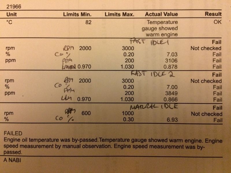

I wouldn't use the MSPB to adjust fuelling for the MOT test cells - because it will change fuelling everywhere - and if you lean it out, that might very bad for the engine in the upper load/speed sites.
Given that the idle sites are at closed throttle, there is very little damage you can really do here - so if you're going to do anything, I would wind the fuelling down on just these sites - using the trim in the live settings page to work out a reasonable setting and then commit that cell to the fuelling table. Then take it to Emerald ;-)

Here's the emissions fail sheet to show how badly it failed.
I'm going to reduce the fueling as configured just now, but have also just received this for getting it sorted properly after MOT complete.
