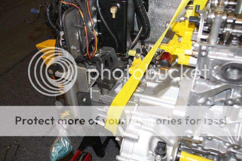

Anyhow, since I didn't clearly show how to fit the engine earlier in this thread, I thought I would include a couple photos on how to best accomplish this with little effort. Again, I did this solo so it's really not that hard if done slowly and carefully.
Make sure the car is properly lifted off the ground (at least 10-12 inches). Tip the Transmission down at a 45 degree angle.
Starting with the trans, rotate the engine into place carefully and position your floor jack under the trans.
Slowly raise the trans up to level the engine between the chassis rails. Attach the front engine mounts but don't yet torque the bolts.
Continue to raise the trans up with the floor jack until engine is level.
Attach the trans mount, but again, don't torque the bolts yet. Install the lower anti-rotational mounts and torque all attachments together.

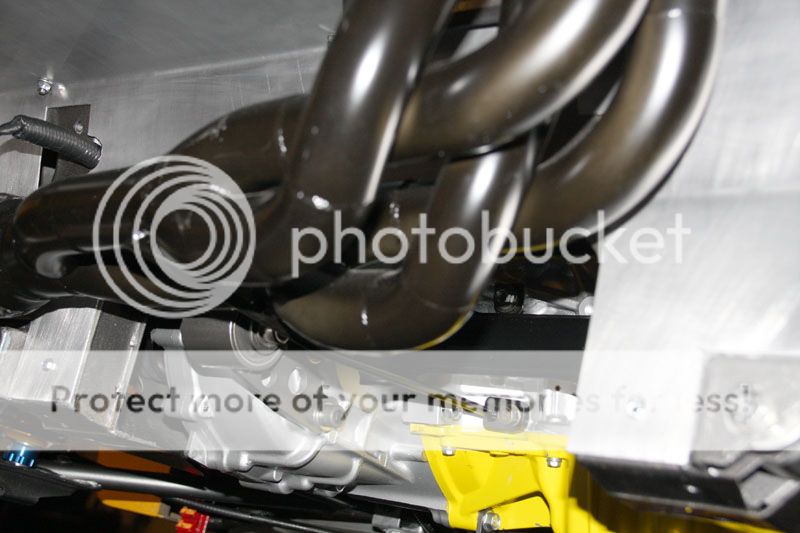

One other cool thing I wanted to show you was the header stabilizer Full Blown fabricated. Since the header pipes come straight off the engine (10-12 inches), it was appropriate to minimize stress where the manifold attaches the head.
Here it is mounted and it keeps the headers rigid with the engine.

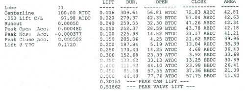

Originally, I had planned to use IPS K10's with a 50 degree VTC gear, but after discussing the issue with Larry @ Endyn, and the risk involved when using 12.5:1 pistons on a high-rpm K24 (bottom end designed for 9500 rpm), I didn't want to chance piston to valve collision at full spin.
I also opted to go with Endyn's cam, which is very smooth, but may be more of a mild Stage 1 (when compared to other cams on the market). Here's the specs on the Endyn Cams.
Endyn Intake Cam
Endyn Exhaust Cam
