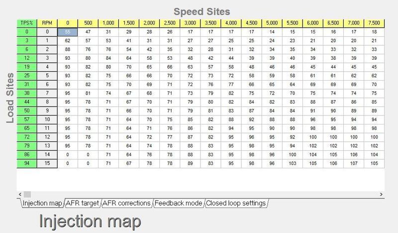

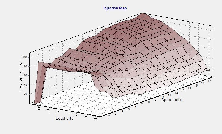

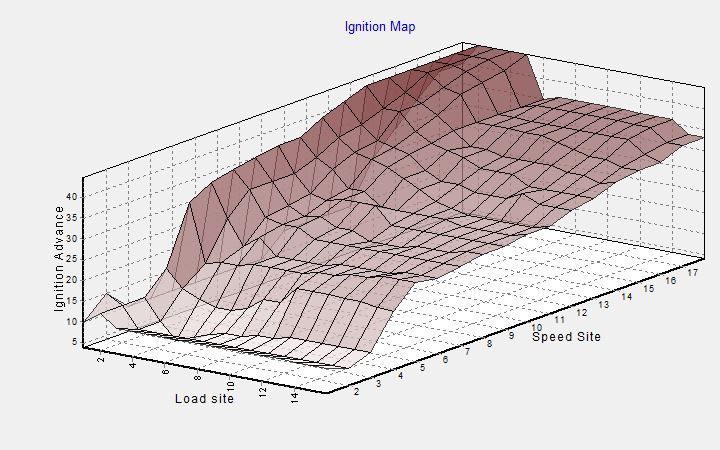

Take a screen shot and post your fuel map and the 3d map as pictures. Also the ignition 3d map.

Posts: 3968

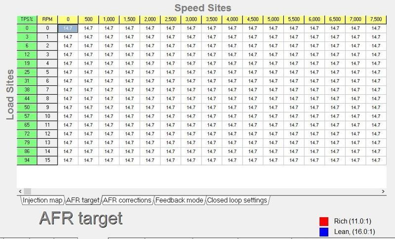

AFR target is blanket set to 14.7 and there are no AFR corrections.
At one point when viewing the live feed after starting the car and watching while it idled. I saw the AFR target map showing 12.4 across the board and with a red hue. I suspect that was a warm up adjustment? I'm not near the car so I can't go out and review/repeat what I saw. Getting slowly familiar with navigating the software but not enough to say with confidence when and where I saw this.

Sorry, but you need to get that on a rolling road or re-map it live while someone drives. Both the ignition and fueling 3d map are miles out. On the fueling the 3500 speed site is less than everything around it as is the 5000. The ignition map is all over the place, it should be much smoother transition into advance especially in the mid range. And why would you need huge advance at light throttle.
If your engine is essentially a 190 spec motor then email emerald for a new base map, it will be much closer to what you need and probably a better starting point for getting it mapped properly. And you can't rely on a narrow band sensors for accurate Lambda readings, it has to be wide band. Agree with Robin on the LC-1 with an emerald, nightmare! get a plx wide band. Self calibrates and a piece of p#ss to wire in.

Edit: out of interest could you pop up a pic of the AFR target map, just out of curiosity :D

The AFR target is all 14.7 as I mentioned. Pic as requested

Mikie711 wrote:Sorry, but you need to get that on a rolling road or re-map it live while someone drives. Both the ignition and fueling 3d map are miles out. On the fueling the 3500 speed site is less than everything around it as is the 5000.
There is often a torque dip at "lower" engine speeds (remember this is a higher revving engine) and so there is often a corresponding fuelling dip.
Again, this is common, although usually only seen at lower speed sites, it is the equivalent of vacuum advance on an old distributor. You need more advance when there is less oxygen, I believe. Also it is common to map in a lot of advance below the idle speed to bump the engine out of stall back into idle.
Provided your fuel pump, fuel pressure regulator and injectors are standard, this is OK approach. Otherwise the fuelling will be the right shape, but the wrong actual numbers and you would need to rescale the injector pulse widths to compensate for the difference in fuel flow rate. Also the idle tends to be more individual as the amount of fuel you have to pour into an engine like this at idle is extremely sensitive to intake air speed which in turn is dependent on all sorts of mechanical features of the intake path. At wide open throttle it's more predictable for a given setup (or at least less different between engines).

Note that whilst all Emerald K6 maps have AFR target maps, most of them don't have it enabled - so Ferg, if you want to know whether or not your AFR map is meaningful, you need to look at the settings pages to see whether adaptive fuelling is enabled.
